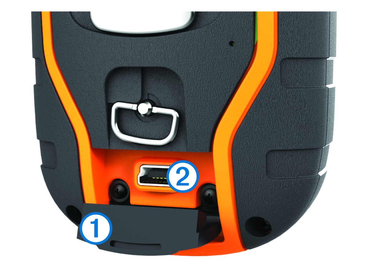

To prevent corrosion, thoroughly dry the USB port, the weather cap, and the surrounding area before charging or connecting to a computer.
You should fully charge the battery before you use the device for the first time. Charging a fully depleted battery takes about 2 hours.
NOTE: The device does not charge when it is outside the temperature range of 0° to 40°C (32° to 104°F).
  1. Lift the weather cap Callout number one.
    Close-up view of the charging port and weather cap with callouts
  2. Plug the small end of the power cable into the mini-USB port Callout number two on the device.
  3. Plug the other end of the power cable into an appropriate power source.
The LCD display on the handheld device shows the current battery charge level. Charging is complete when the battery charge level icon stops flashing.
