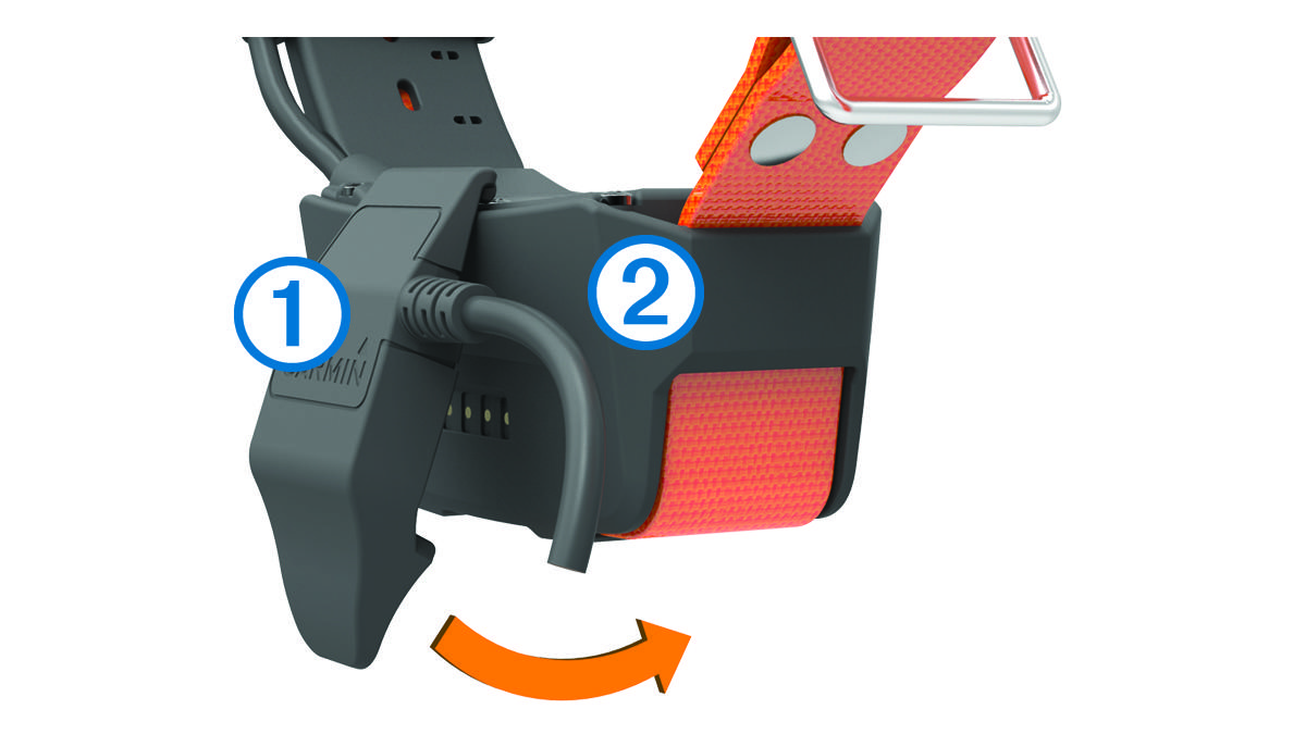

  1. Snap the charging clip Callout number one onto the device Callout number two.
    Diagram of the charger connecting to the dog collar device with callouts
