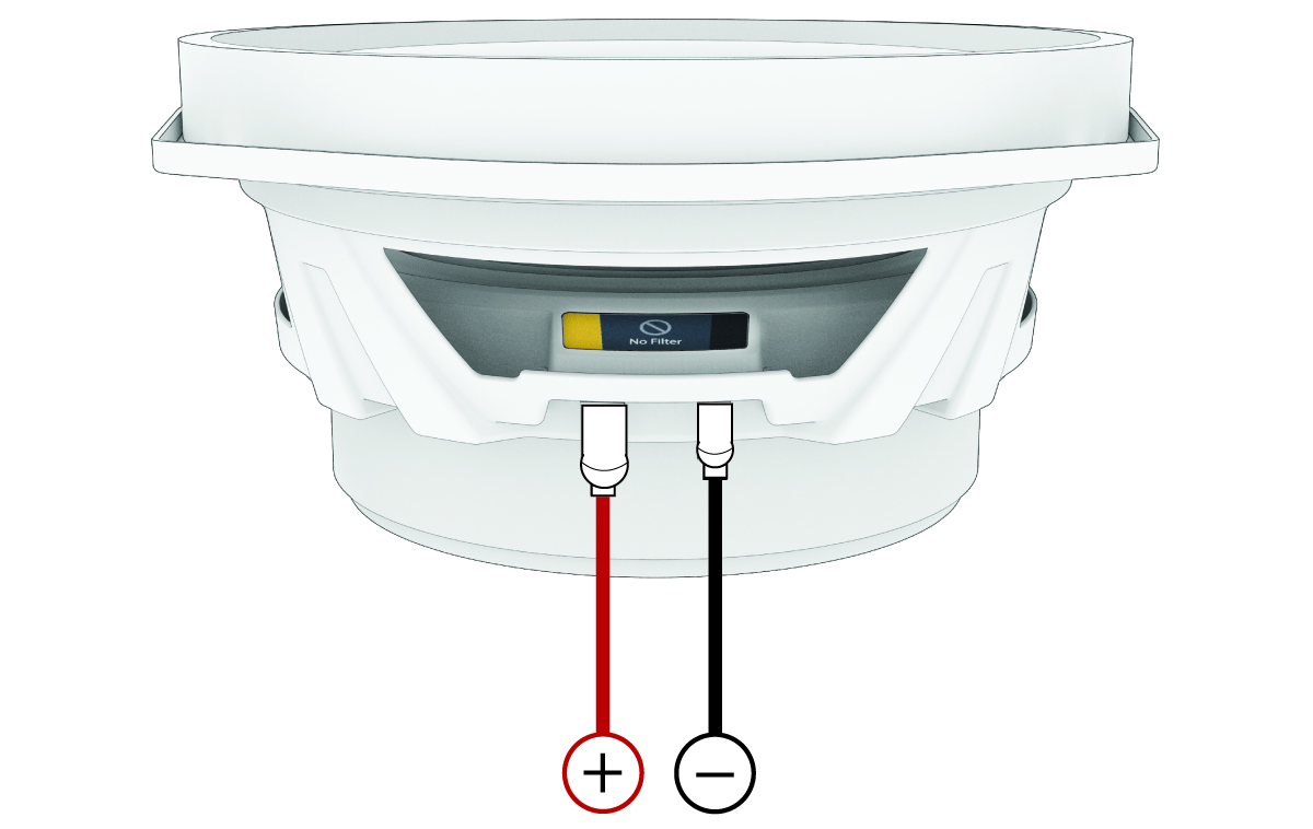

CF-690w Wiring for Use without a Filter
You must use these terminals in active system applications. For optimum performance, you should use a high-quality digital signal processor (DSP) or an active crossover and a dedicated amplifier channel. You should set your filter to low-pass at 550 Hz, at a rate of 18 dB/octave.
