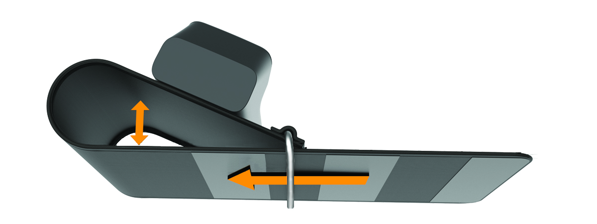

  1. Unfold the cuff strap.
  2. Grip the retaining bar, and loosen the cuff strap by pulling the cuff strap through the retaining bar until it forms a loop.
    TIP: If necessary, pull the retaining bar away from the device to begin forming the loop.
    Top view of the device and cuff with arrows
  3. Fold the cuff strap over the retaining bar, and fasten the hook and loop strap.
