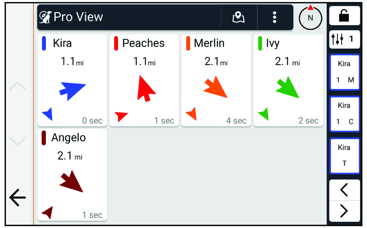

From the main menu, select Pro View.
Screenshot of the Pro View feature
You can use the pro view feature to view the direction and distance to your dog and any paired devices. The pro view feature also shows the dog's status, such as running or on point (Dog Status Icons). The color of each pointer corresponds to the color of the track on the map.
The direction and distance are most accurate when the dog or paired device is more than 9.1 m (30 ft.) away. When the dog or paired device is less than 9.1 m (30 ft.) away, "Near" appears.
