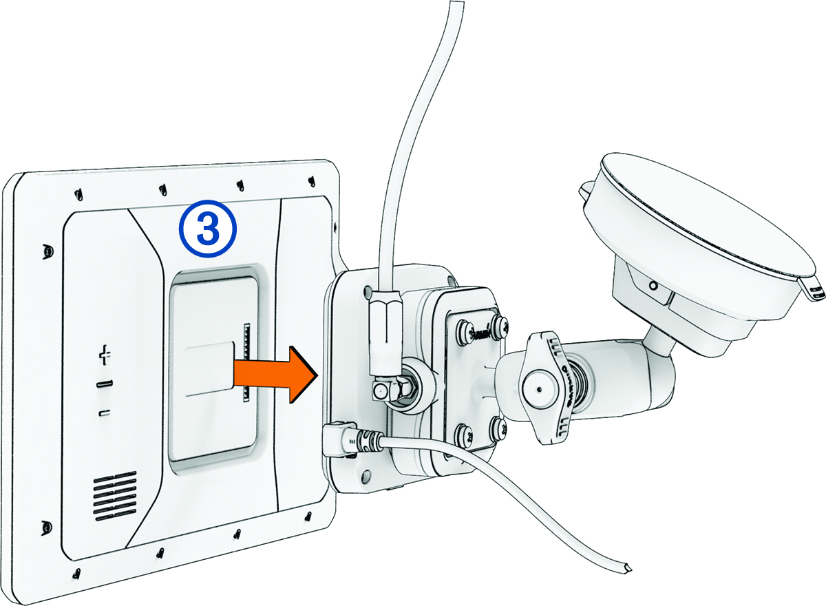

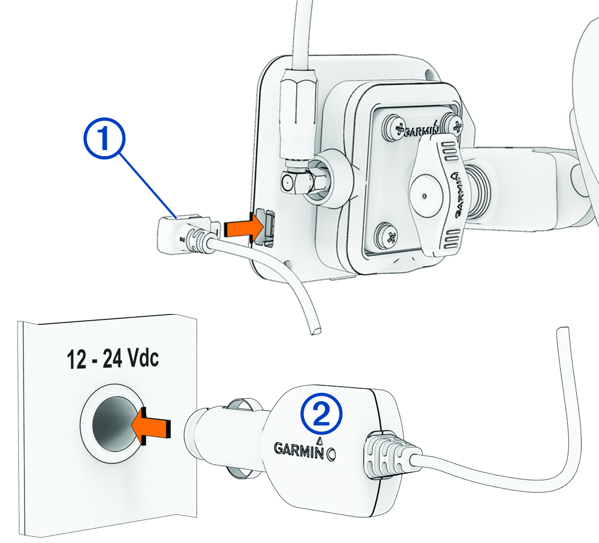

Connecting the Mount and Navigator to Vehicle Power Plug the small end of the power adapter cable 1 into the port on the side of the powered mount. Plug the vehicle power adapter 2 into the power outlet in your vehicle. Connect the Alpha® XL navigator 3 to the magnetic mount. If necessary, turn on the vehicle ignition switch to provide power to the power outlet in your vehicle. Parent Topic: InstallationHomeGetting StartedInstallationConnecting the Mount and Navigator to Vehicle Power
