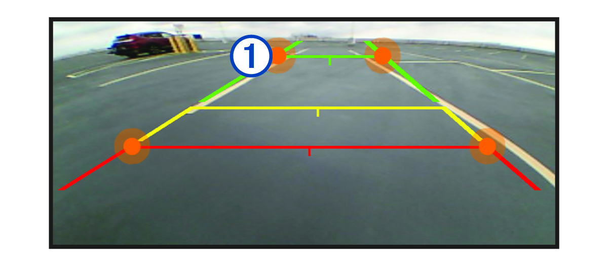

    • From the camera view, tap the screen, and select Guidance lines.
    • From the camera view, select Wrench > Adjust Video.
  3. Drag the circles on the corners of the guidance lines 1, or tap the arrows until they match the angle and position of the curb, driveway, or parking stall lines.
    The guidance lines should appear directly on top of your reference points.
    The red or orange section of the guidance lines should align with the rear of your vehicle.
    Screenshot of guidance lines with a callout
  4. If necessary, reposition the vehicle with the other side closely aligned to a curb, driveway, or parking stall lines, and repeat the alignment process.
    You should attempt to keep the guidance lines symmetrical, even if your vehicle is not in perfect alignment with the curb, driveway, or parking stall lines.
  5. Select Checkmark after alignment is complete.
