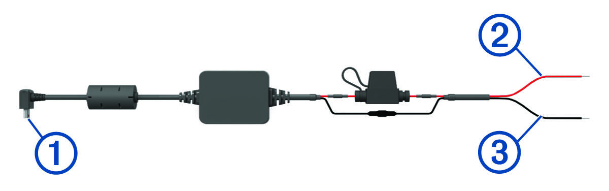

Bare wire power cable with callouts
1
Device power connector
2
10 to 30 Vdc system input power (red)
3
System ground (black)
