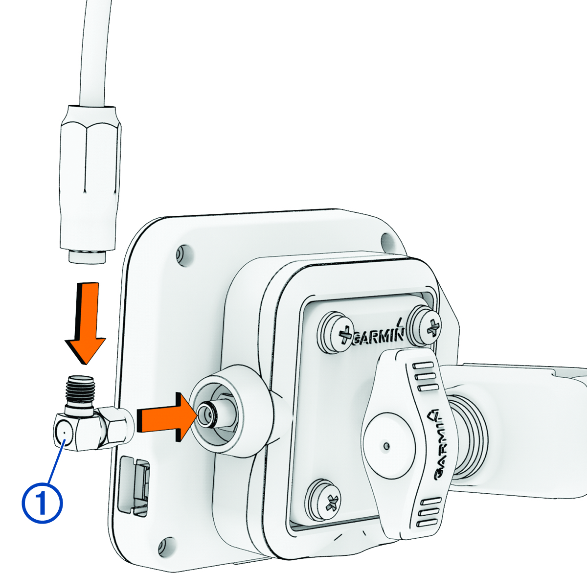

  1. Connect the angled antenna adapter 1 to the antenna port on the magnetic mount.
    TIP: You can connect the antenna cable directly to the antenna port if you do not need to change the angle of the cable.
    Antenna installation with a callout
  2. Connect the cable from the magnetic VHF Antenna to the angled antenna adapter.

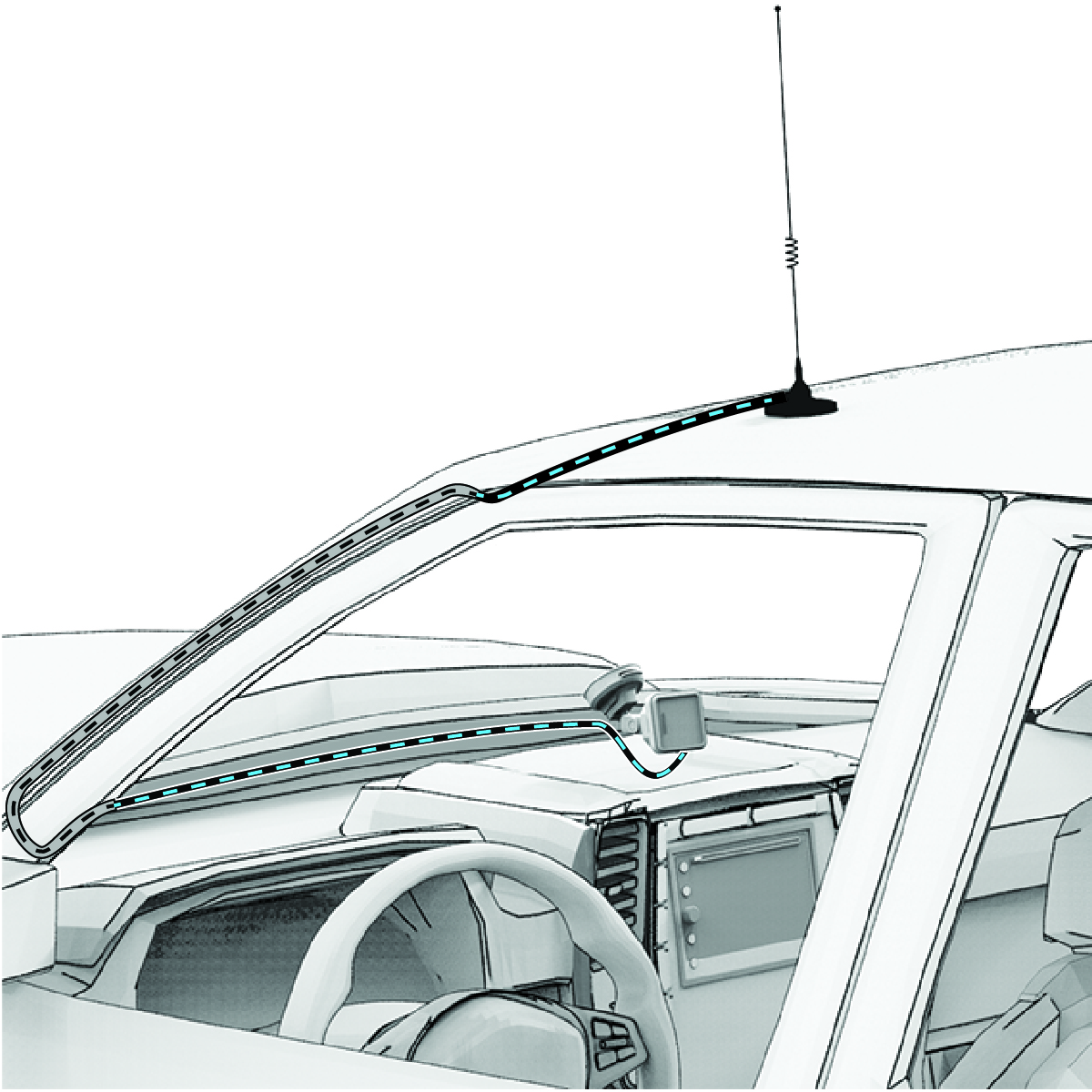

  3. Route the cable through a suitable path in your vehicle.
  4. Place the magnetic antenna on the roof of your vehicle.
    Antenna positioned on the roof of a vehicle
