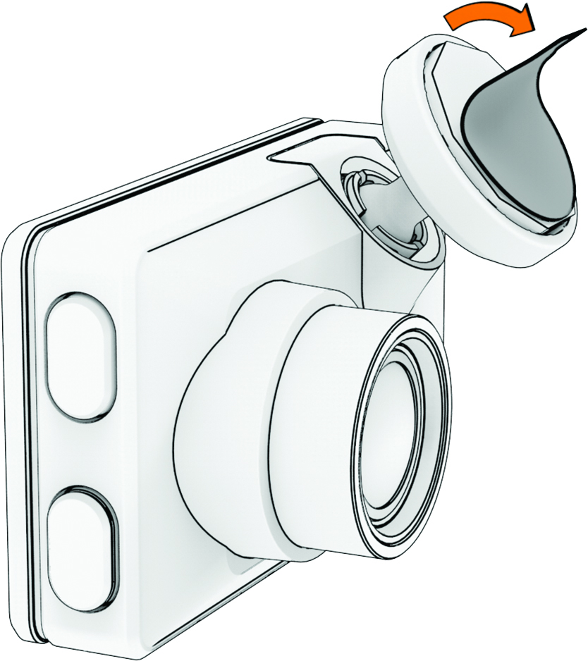

  3. After you have selected a mounting location with a clear view, remove the protective film from the mount adhesive.
    Protective film peeled away from the mount adhesive

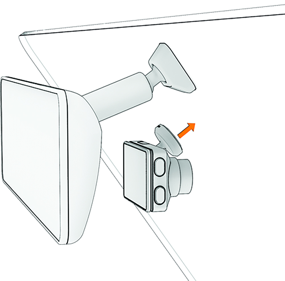

  5. Press the mount firmly onto the windshield, and maintain pressure for 30 seconds.
    This helps to ensure the mount adhesive has proper contact with the windshield.
    Camera and mount pressed onto a windshield
