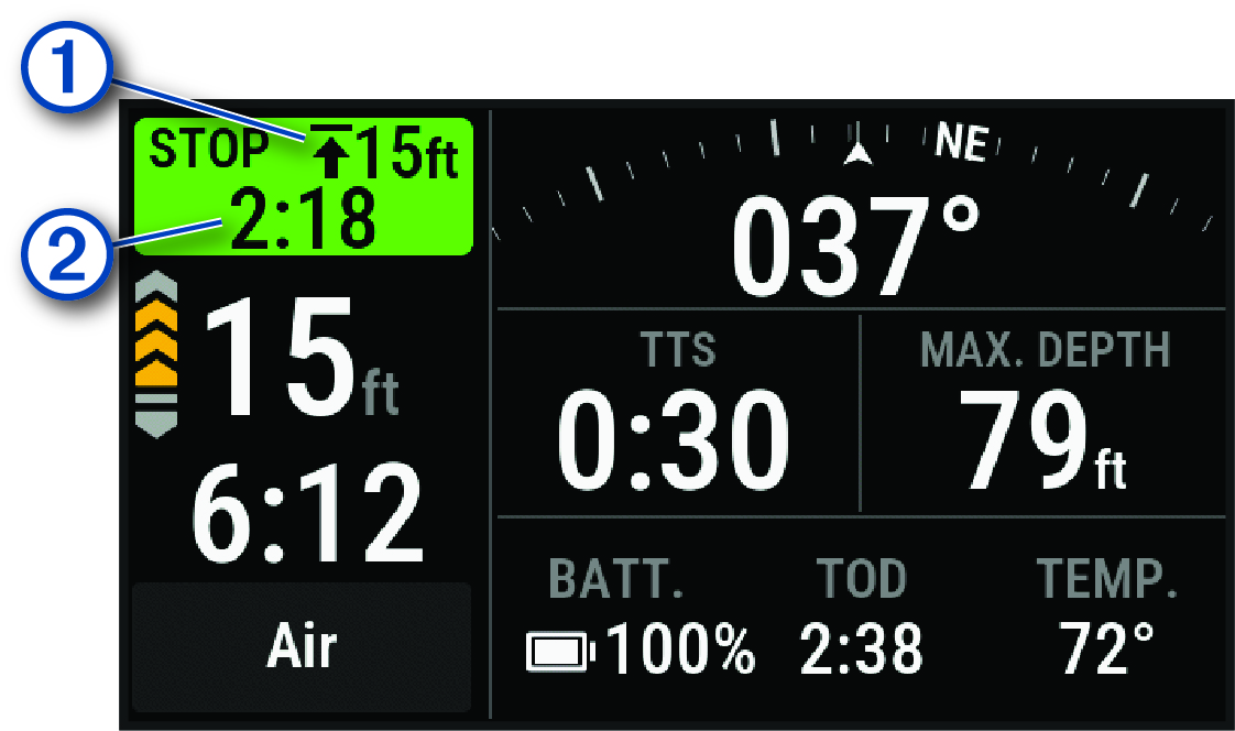

    Safety stop information appears on the data screens.
    Safety stop data with callouts
    1
    The safety stop ceiling depth.
    2
    The safety stop timer.
    When you are within 1 m (5 ft.) of the ceiling depth, the timer starts counting down.
