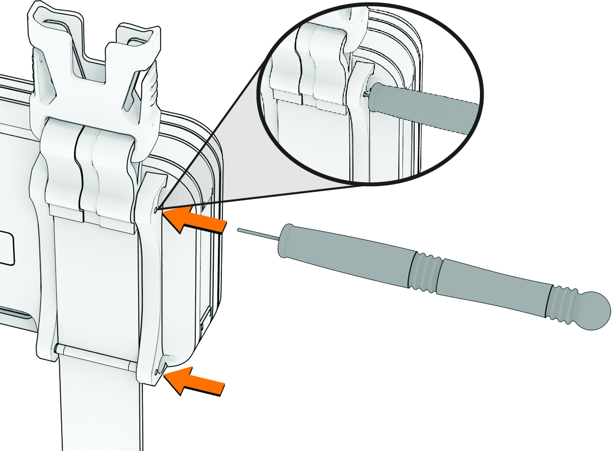

  1. Use the included pin removal tool to push in the pin on one of the bands, and remove the pin.
    Band pins being removed
  2. Repeat step 1 on the second pin.
  3. Remove the band.

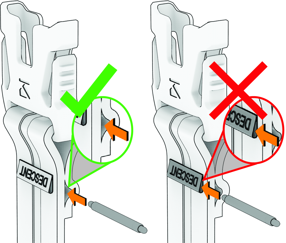

  4. Insert a pin through the double-stitched loop on the new band.
    NOTICE
    Do not insert the pin through the product tag. This may cause the tag to tear.
    Pin being installed on new band

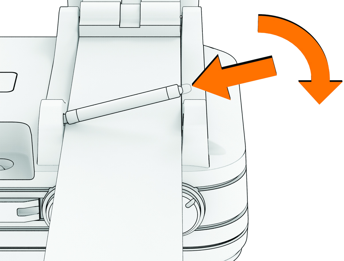

  5. Install one end of the pin into the corresponding hole on the dive computer.
  6. Push in the exposed pin, and press it into place.
  7. Install the second pin above the band.
    Close-up view of a band pin being installed
