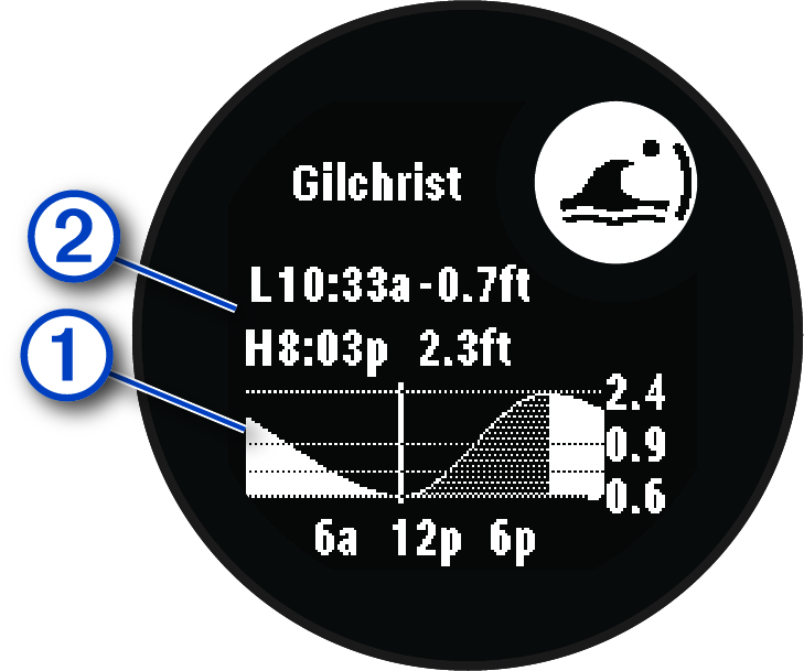

    A 24-hour tide chart appears for the current date with the current tide height 1 and information about the next tide 2.
    Tides chart with callouts
