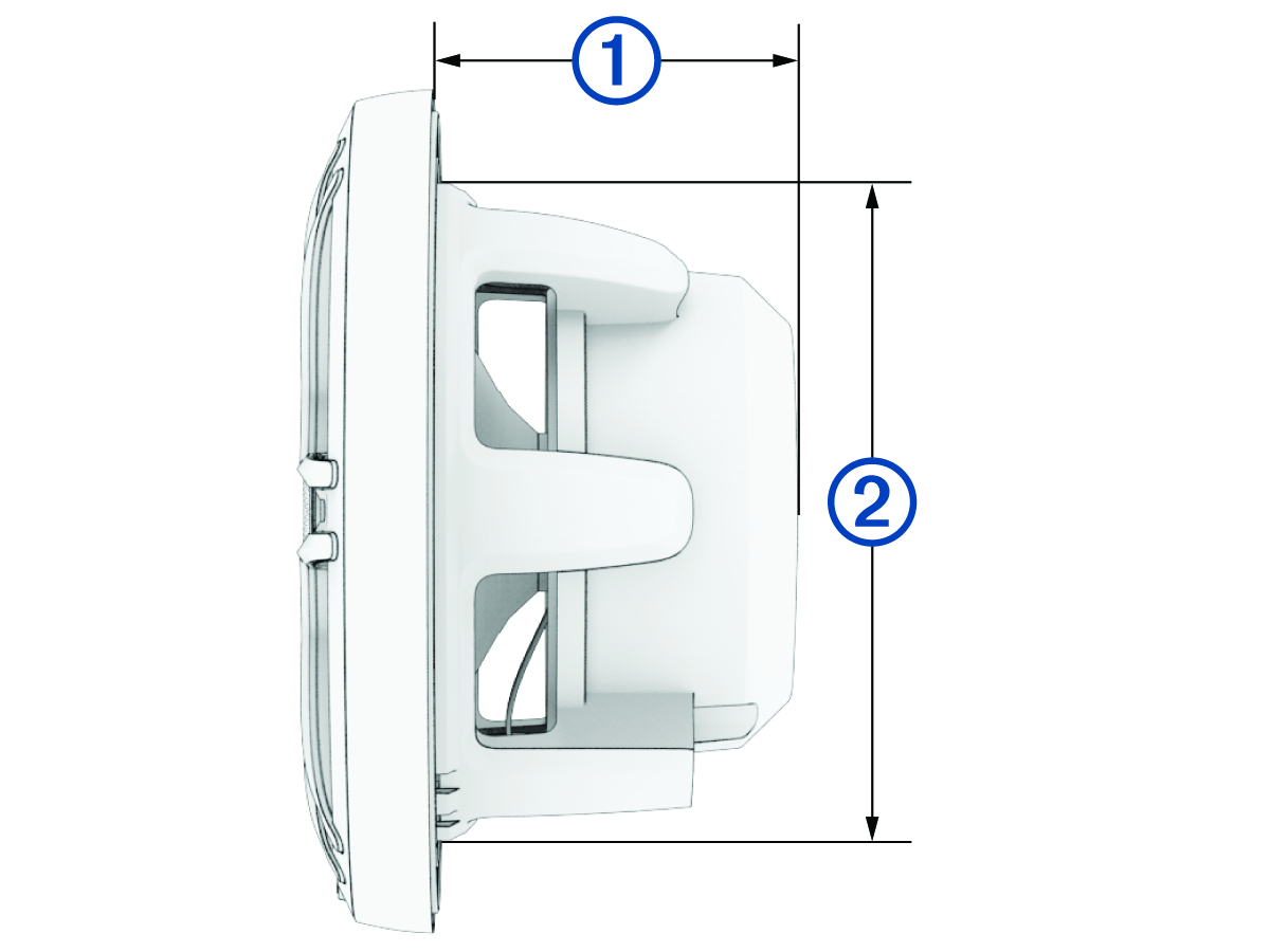

Side View
Side view of speaker with callouts
Dimension
6.5" Speakers
7.7" Speakers
8.8" Speakers
1
73.6 mm (27/8 in.)
81.9 mm (3 1/4 in.)
100.9 mm (4 in.)
2
133 mm (5 1/4 in.)
153 mm (6 in.)
177 mm (7  in.)
NOTE: You must allow at least 3 mm (1/8 in.) of clearance beyond the depth of the speaker. The above measurements are nominal. Refer to the specifications table for clearance measurements.
