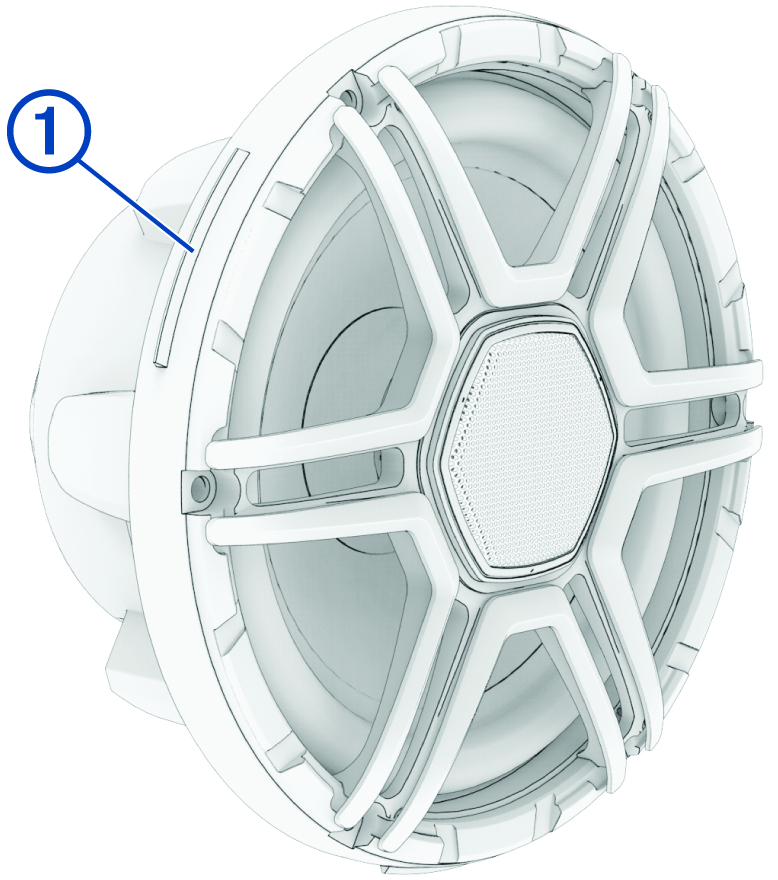

  1. Locate the retention tabs on the edge of the speakers 1.
    Speaker grille retaining clips
    NOTE: When the speakers are installed with the connectors on the back at the bottom (with the Fusion® logo on the front in the 6 o'clock position), the retention tabs are located at the 2 o'clock, 6 o'clock, and 10 o'clock positions on the edge of the speakers.
  2. Aligning the notches on the inside of the grille with the retention tabs on the speaker, place the grille on the rim of the speaker.
  3. Press on the grille to snap it in place.
