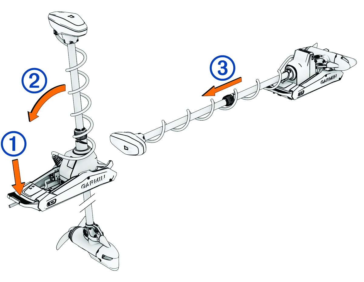

  1. Hold down the pedal to release the latch 1.
    motor stowage diagram with glyphs
    NOTE: The motor should automatically steer to 90° for stowing. The propeller stow side can be configured in the settings menu.
  2. Tilt the shaft back 2, and then raise the motor slowly while tilting the shaft to the horizontal position.
  3. Slide the motor into the motor catch until it locks in the stowed position 3.
