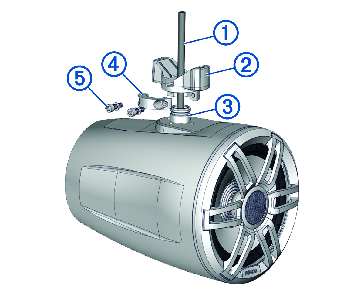

  3. Feed the cable Callout number 1 from the speaker through the base of the bracket Callout number 2.
    Bracket base install with callouts
  4. Place the base of the bracket over the mounting knob on the speaker Callout number 3.
  5. Using a 4 mm hex driver or hex key, attach the collar Callout number 4 to the base of the bracket using the two shorter screws and washers Callout number 5, but do not fully tighten them.
