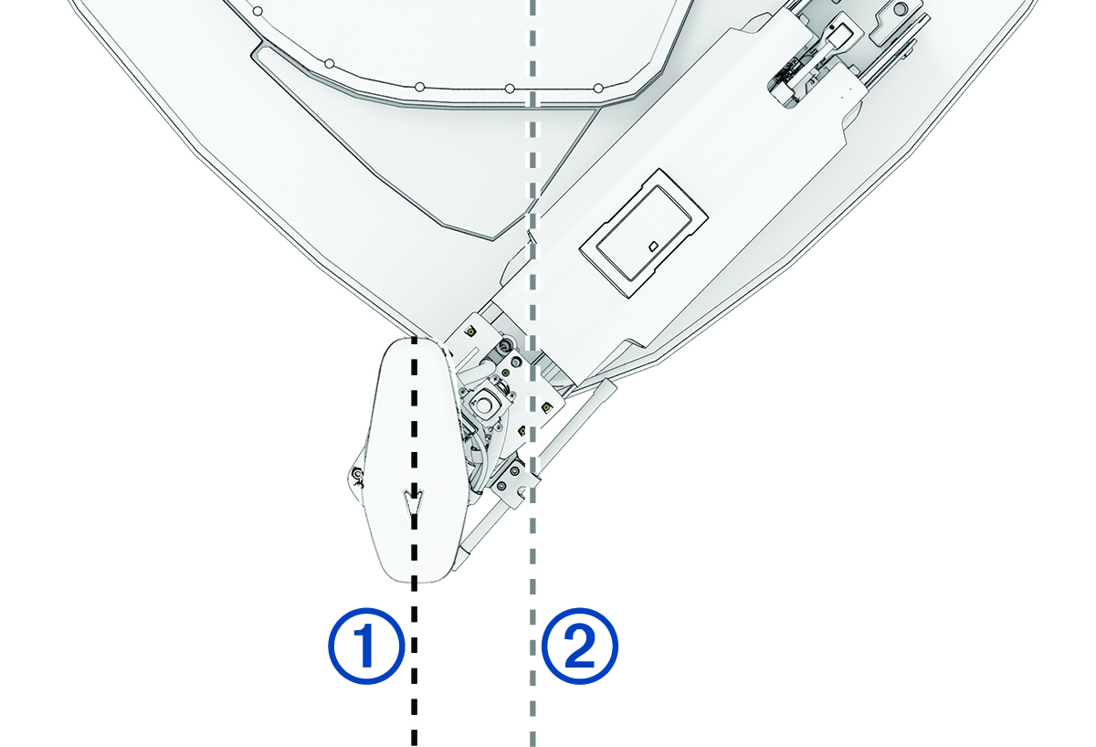

Based on the installation angle, the trolling motor may not align with the center line of your boat. For the best results, you should set the bow offset.
  1. Using the remote control, adjust the angle of the trolling motor 1 so it aligns with the center line of your boat 2, pointing straight forward.
  2. On the remote control, select Menu icon > Settings > Trolling Motor > Calibrate > Bow Offset.
  3. Press Left arrow or Right arrow to adjust the bow offset.
  4. Press Down arrow to set the bow offset.
  5. Repeat this procedure if necessary.
