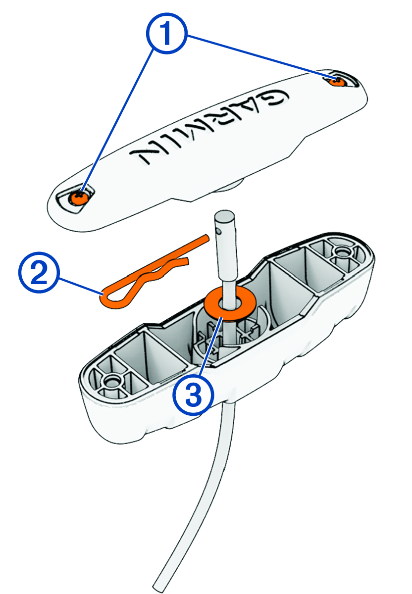

  1. Transition the motor to the stowed position, and secure the safety strap.
    CAUTION
    You must keep the motor in the stowed position with the safety strap secured until you have finished servicing your motor. If the mount is not securely locked in the stowed position while you work, it may shift and crush your hands or fingers.
  2. Using a #1 Phillips screwdriver, loosen the two screws Callout number 1 that secure the top of the handle.
    Pull-cable handle disassembly with callouts
  3. Push the pull cable up from the bottom of the handle, and remove the R-pin Callout number 2.
  4. Pull the cable out through the washer Callout number 3 and the bottom of the handle.
