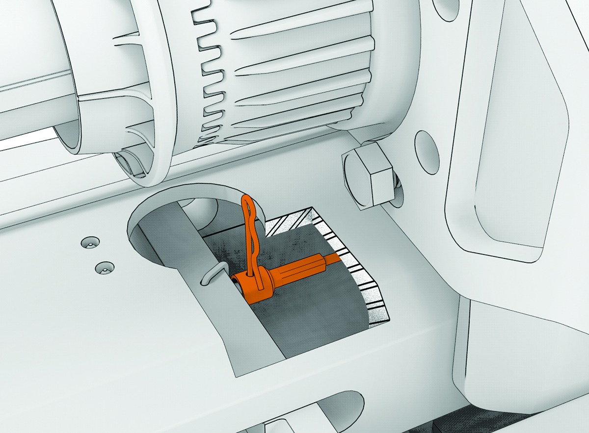

  1. Locate the access hole on the lower link, near the depth adjustment collar.
  2. Using needle-nose pliers, remove the R-pin that secures the pull cable to the locking mechanism.
    R-pin location
  3. Remove the end of the pull cable through the access hole, and pull to remove the rest of the cable from the steering servo housing.
