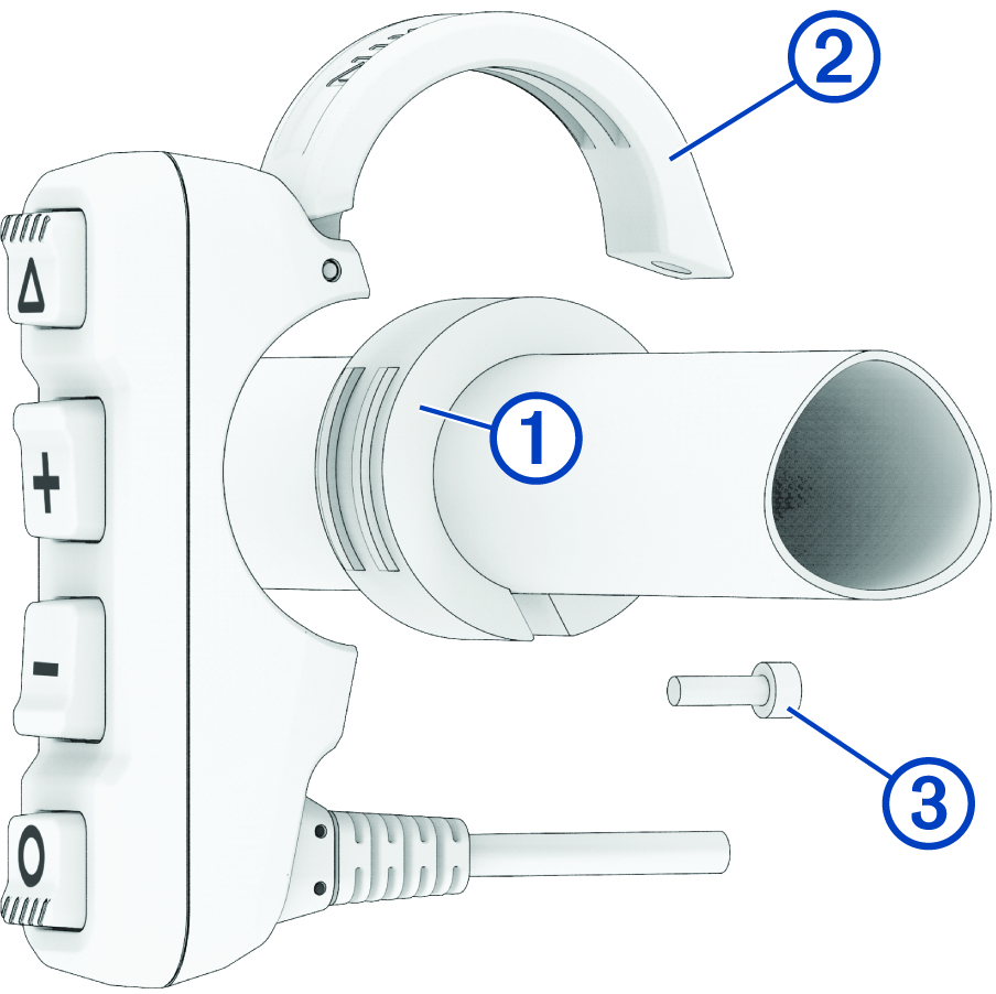

Installing the Controller on the Handlebar
The handlebar controller is packaged with three bushings, designed for 22 mm (7/8 in.), 25 mm (1 in.), and 32 mm (11/4 in.) diameter handlebars.
We recommend installing the handlebar controller close to the left handle of your vehicle, within reach of your thumb.
  1. Place the bushing Callout number 1 on the handlebar, in the mounting location for the controller.
    Exploded view of handlebar controller with callouts
  2. Place the handlebar controller mounting clamp Callout number 2 over the bushing, making sure the ridges on the bushing match up with the grooves in the mounting clamp.
  3. Using the included hex wrench, install the included screw Callout number 3.
