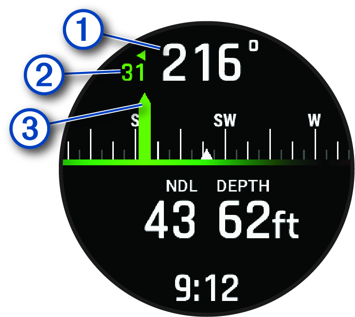

  1. During a Single-Gas, Multi-Gas, CCR, or Gauge dive, scroll to the dive compass.
    Dive compass with callouts
    The compass indicates your directional heading 1.
  2. Press START to set the heading.
    The compass indicates deviations 2 from the set heading 3.
    TIP: You can set the heading from any of the dive data screens by holding START and DOWN.
  3. Press START, and select an option:
    • To reset the heading, select Reset Heading.
    • To change the heading by 180 degrees, select Set to Recip..
      NOTE: The compass indicates the reciprocal heading with a red mark.
    • To set to a 90-degree heading left or right, select Set to 90L or Set to 90R.
    • To clear the heading, select Clear Heading.
