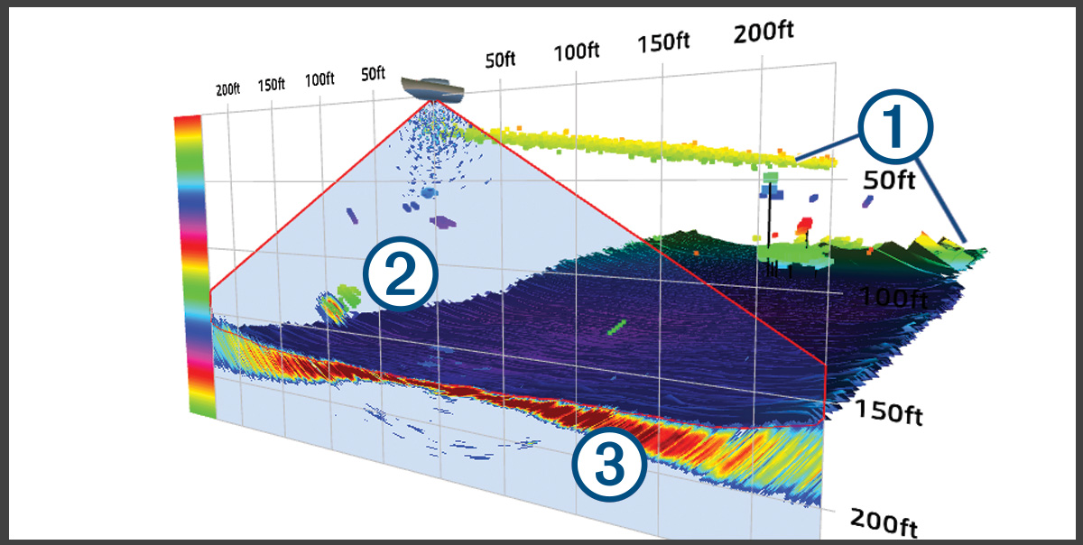

You can enable the LiveVü Layer view on the RealVü 3D Historical sonar view only when using a compatible transducer, such as a Panoptix™ PS70-TH.
The LiveVü Layer view adds the LiveVü down view to the RealVü 3D Historical sonar view.
To enable the LiveVü Layer view on the RealVü 3D Historical sonar view, select Options > LiveVü Layer.
RealVü 3D historical livevu sonar view with callouts
1
RealVü 3D Historical bottom, structure, and fish
2
LiveVü down view structure and fish
3
LiveVü down view bottom
