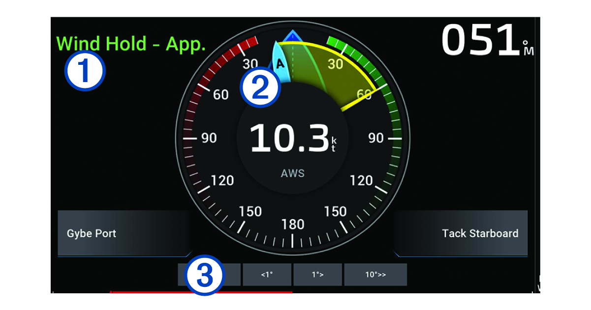

You can set the autopilot to maintain a specific bearing relative to the apparent or true wind angle. You must connect a compatible wind sensor the same NMEA 2000® network as the autopilot system to perform a wind hold or wind-based steering maneuvers.
Wind hold autopilot screen with callouts
1
Autopilot status information
Standby and Autopilot status indicator appear in gray when the autopilot is in standby mode.
Wind Hold and Autopilot status indicator appear in green when the autopilot is engaged in wind hold.
2
Wind gauge
Shows the true wind speed (TWS) or apparent wind speed (AWS)
3
Rudder position indicator
NOTE: This functionality is available only when a rudder sensor is connected.
