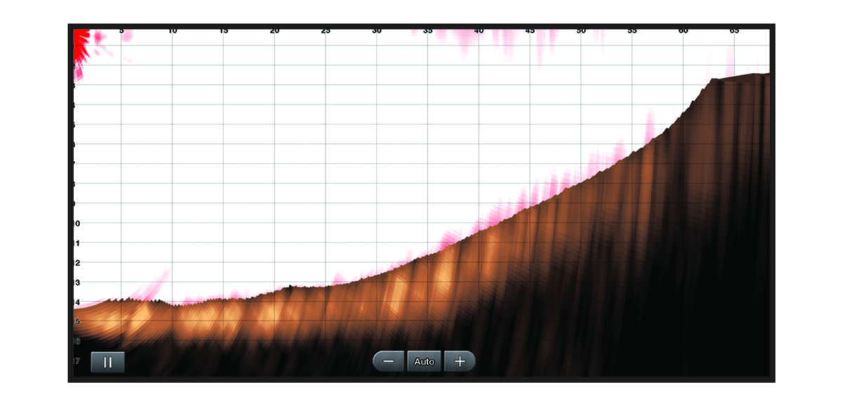

The Panoptix™ Garmin FrontVü™ sonar view increases your situational awareness by showing obstructions under the water, up to 91 meters (300 feet) in front of the boat.
The ability to effectively avoid forward collisions with Garmin FrontVü sonar decreases as your speed rises above 8 knots.
To see the Garmin FrontVü sonar view, you must install and connect a compatible transducer, such as a PS21 transducer. You may need to update the transducer software.
