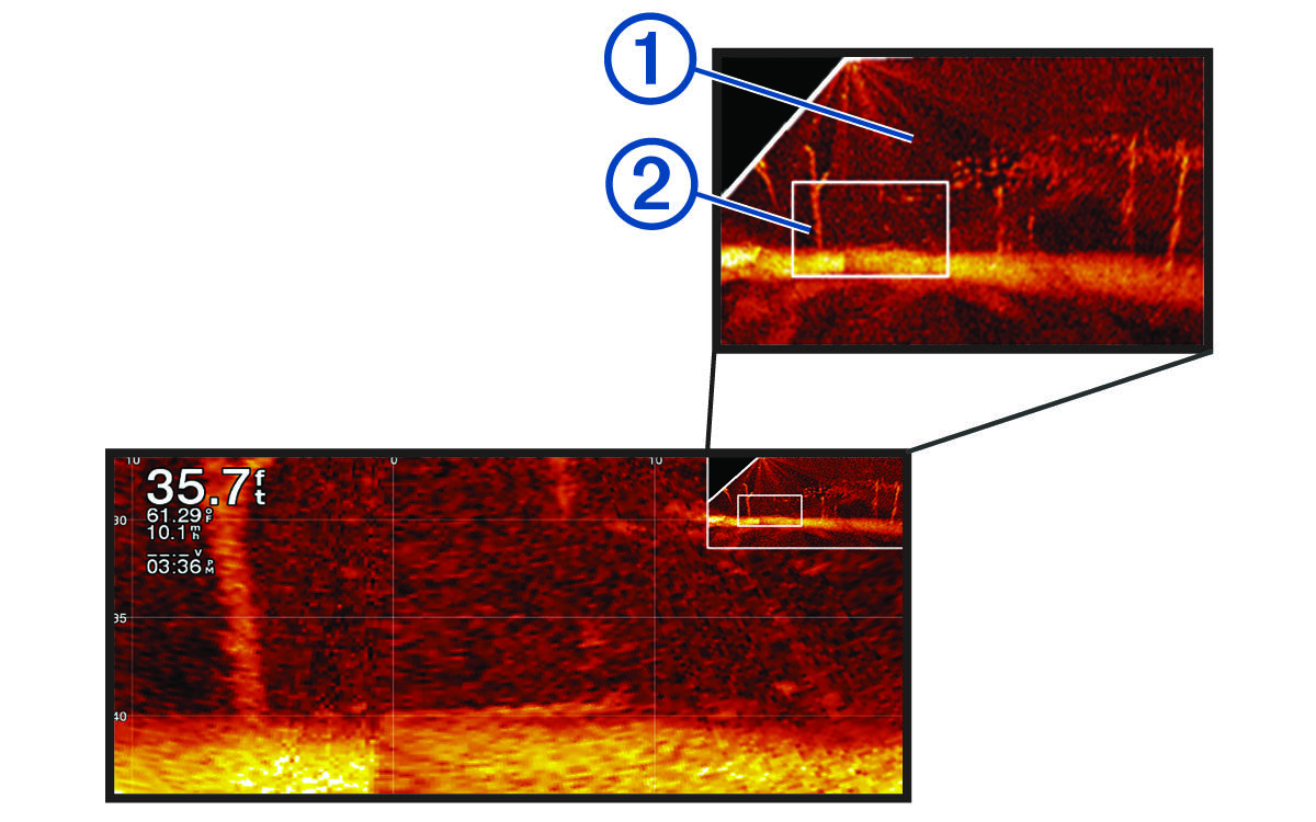

  1. From a Panoptix LiveVü or LiveScope 2D sonar view, spread two fingers apart to zoom in on the area.
    An inset window 1 appears and displays a small version of the full-screen image. The boxed area 2 in the inset shows the location of the zoomed area.
    Panoptix view with pan and inset with callouts
  2. If necessary, tap or drag within the inset window to view a different area of the full-screen view.
  3. If necessary, spread two fingers apart to zoom in.
  4. If necessary, pinch two fingers together to zoom out.
To exit zoom mode, select Back or pinch two fingers together to zoom out until the screen returns to a full-screen view.
