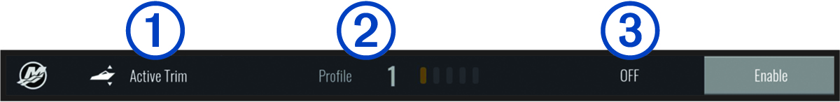

Mercury Active Trim Overlay
Mercury active trim bar with callouts
1
When enabled, you can manually adjust the trim.
2
When enabled, you can change between Mercury active trim preset profiles.
3
Active trim system status.
Enable or Disable
Select to turn the active trim system on or off.
