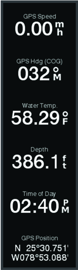

Customizing the Data Overlays
You can customize the data in the data overlays shown on a screen.
Data fields
  1. Select an option based on the type of screen you are viewing:
    • From a full screen view, select Options > Edit Overlays.
    • From a combination screen, select Options > Edit Combo > Overlays.
    • From a SmartMode™ screen, select Options > Edit Layout > Overlays.
    TIP: To quickly change the data shown in an overlay box, hold the overlay box.
  2. Select an item to customize the data and data bar:
    • To show the data overlays, select Data, select the location, and select Back.
    • To change the data shown in an overlay box, select the overlay box, select the new data to show, and select Back.
    • To customize the information shown when navigating, select Navigation, and select an option.
    • To turn on other data bars, select Top Bar, Bottom Bar, Left Bar, or Right Bar, and select the necessary options.
  3. Select Done.
