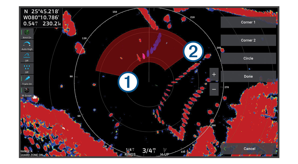

  1. From a radar screen, select Options > Radar Options > Guard Zones.
  2. Select Guard Zone 1 or Guard Zone 2, and then select Menu button.
  3. Drag the cursor to the location of the outer guard-zone corner 1.
    Radar guard zone setup
  4. Select Corner 2.
  5. Drag the cursor to the location of the inner guard-zone corner 2 to define the width of the guard zone.
  6. Select Done.
