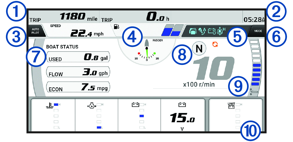

This image is only one example of how this screen may appear based on the number and types of engines or motors connected to the engine network and throttle controller. Consult the owner's manual provided with your Yamaha engine, motor, or display for complete information.
Engine gauges screen with callouts
1
Boat data fields
Hold to replace the data.
2
Current time
Hold to view trip data.
3
Select to toggle the autopilot bar on and off (Helm Master® EX).
Select to set the joystick button for Set Point functions (Helm Master and Helm Master EX).
4
Tank level information or battery level information
Hold a tank or a battery to view detailed tank level sensor or battery level information.
5
Status icons:
  • Blue: engine or motor function indicators
  • Orange: engine or motor status or condition information
  • Red: engine or motor warning and alert information
GPS signal strength (Helm Master)
6
Select to set the Fish Point settings (Helm Master/Helm Master EX).
Select to set the trolling speed (Helm Master/Helm Master EX/Mechanical RC/Digital Electronic RC (6X6/6X7)).
7
Boat data fields
8
Shift position indicator
Engine RPM
9
Tachometer and trim angle
Hold to change the background.
10
Engine, motor, and boat data fields
Hold to replace the data and change the gauge appearance.
