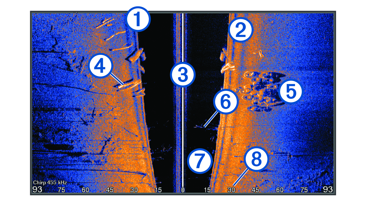

SideVü scanning sonar technology shows you a picture of what lies to the sides of the boat. You can use this as a search tool to find structures and fish.
SideVü sonar view with callouts
1
Port side of the boat
2
Starboard side of the boat
3
The transducer on your vessel
4
Logs
5
Old tires
6
Trees
7
Water between the vessel and the bottom
8
Distance from the side of the boat
