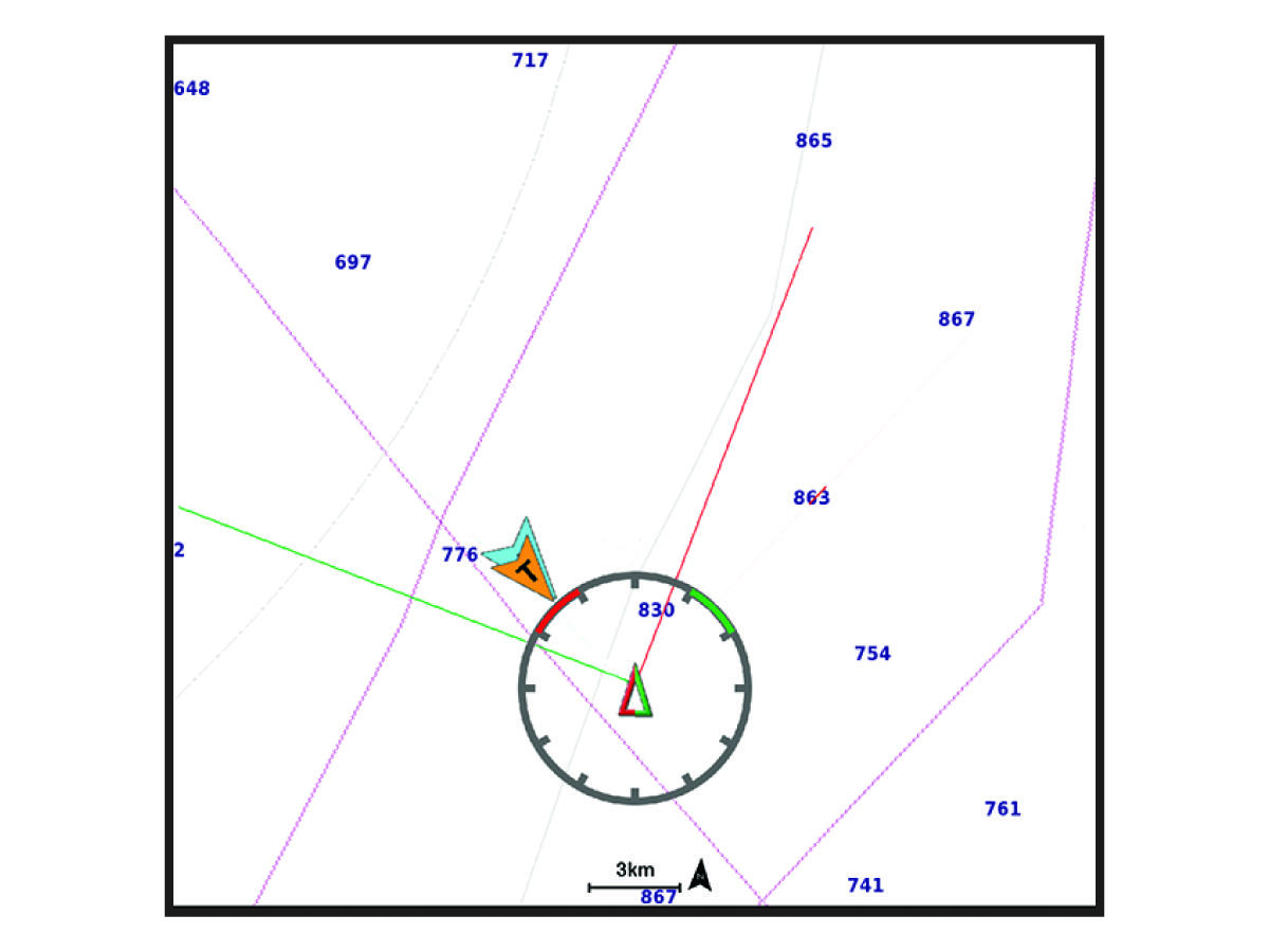

When in sailing mode (Setting the Vessel Type for Sailing Features), you can display laylines on the navigation chart. Laylines can be very helpful when racing.
Sailing laylines on the chart
