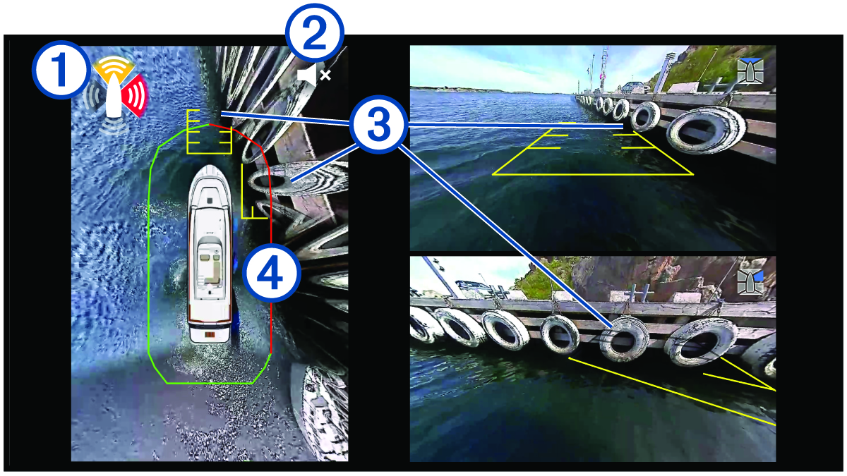

Surround view camera screen proximity alerts
1
Proximity beeper alert notification. Indicates the area of the boat sending the proximity alert (port, starboard, bow, and stern). The color of the shaded area indicates the estimated severity of the alert:
  • Yellow: Level 1 - slow, repeated beep
  • Orange: Level 2 - faster, repeated beep
  • Red: Level 3 - continuous beep
2
Proximity beeper status (Object Detection and Proximity Alert)
TIP: You can select this icon to quickly mute and unmute the proximity beeper.
3
Gray shaded lines indicated objects detected on the distance marker
4
Red lines indicate objects detected on the virtual bumper
