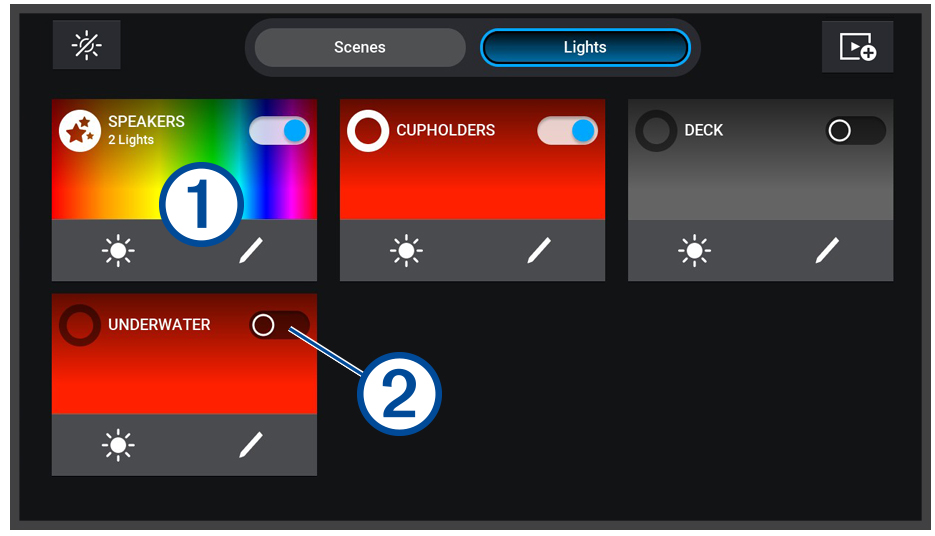

LED Lighting Control Screen
You can access LED lighting screen by selecting Vessel > Lighting.
LED lighting screen with callouts
Turn off all lights icon
Turns off all connected lights and scenes.
Scenes
Shows all created scenes.
Lights
Shows all connected LED lights and light groups.
Create new scene icon
Creates a new scene.
1
Light, light group, or scene name and information.
Select to turn a light or light group on and off.
Select to start a scene.
2
Shows whether the light or light group on and off.
Adjust brightness icon
Quickly adjust the brightness of the light, light group, or scene.
Edit scene icon
Quickly edit the properties, color, and effects of a light, light group, or scene.
