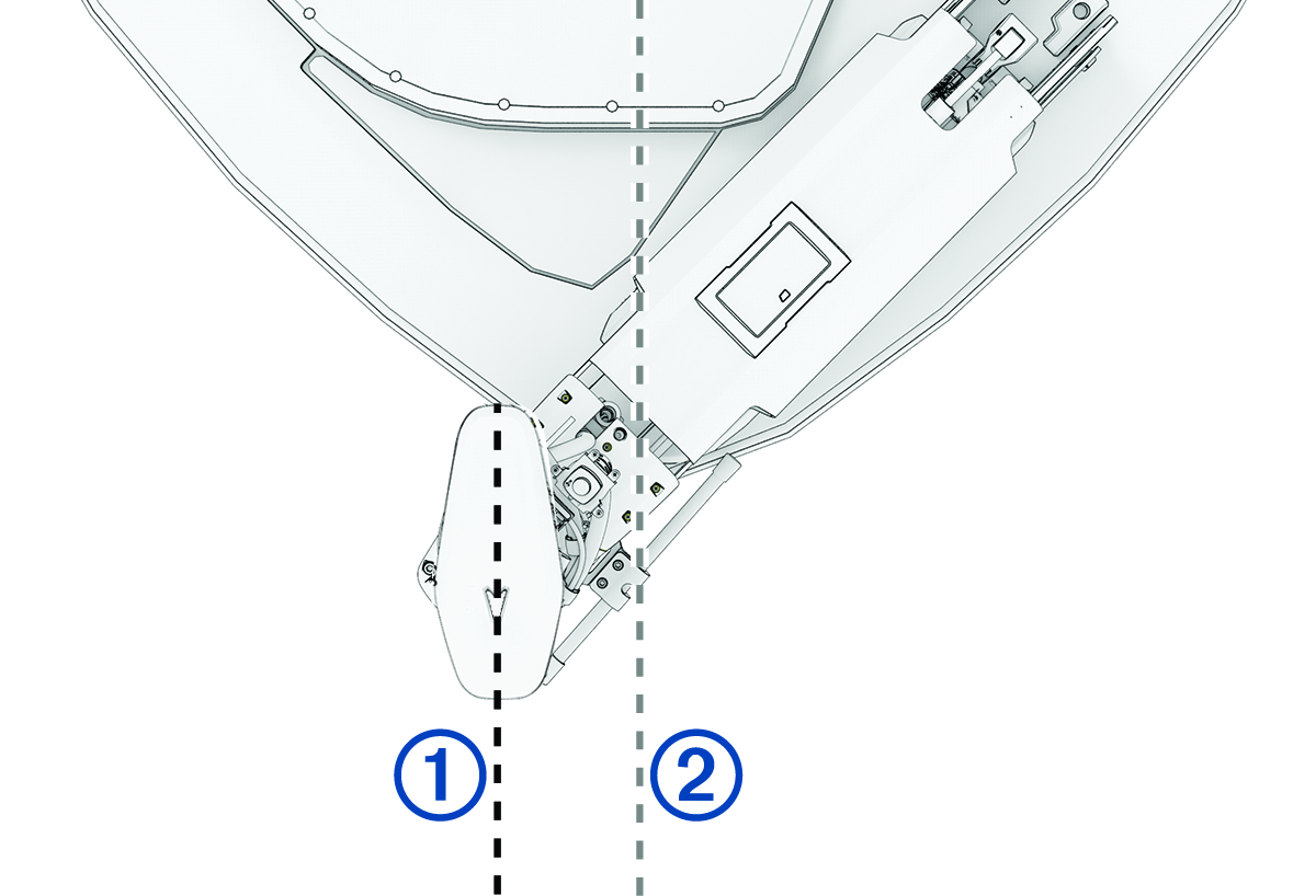

Based on the installation angle, the trolling motor may not align with the center line of your boat. For the best results, you should set the bow offset.
  1. Adjust the angle of the trolling motor 1 so it aligns with the center line of your boat 2, pointing straight forward.
    Bow offset with callouts
  2. From the trolling motor bar, select Menu symbol > Calibrate > Bow Offset.
