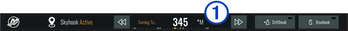

When connected to a compatible Mercury® engine, you can use the Skyhook digital anchor overlay on the chartplotter to set and adjust the digital anchor functions.
Depending on the type of hardware installed on your vessel, the Skyhook digital anchor overlay has a different appearance with different controls:
