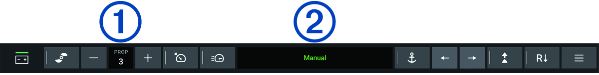

Trolling Motor Control Bar
The trolling motor control bar allows you to control a Force trolling motor and see the status of the motor.
Select an item to engage it. The button illuminates when selected. Select the item again to disengage it.
Trolling motor control bar with callouts
Battery status
Trolling motor battery status.
Propeller
Turns the propeller on and off.
Minus symbol
Reduces the speed.
When the speed reaches 0, continuing to reduce the speed shifts the propeller into reverse thrust.
1
Speed indicator.
Plus symbol
Increases the speed.
If you are running the propeller in reverse thrust, increasing the speed past 0 shifts the propeller into forward thrust.
Cruise control
Enables the cruise control at the current speed over ground (SOG).
Full speed
Engages the propeller at full speed.
2
Trolling motor status.
Anchor lock
Enables anchor lock, which uses the trolling motor to hold your position.
Bow lock
(Replaces anchor lock icon - not available on all models) Some stern-mounted models, such as a Force Current trolling motor, allow you to use the bow as the reference when engaging bow lock (Configuring Bow Lock).
Steer leftSteer right
Steers the trolling motor.
When in anchor lock, jogs the anchor lock position forward, backward, left, or right.
Heading hold
Enables heading hold (set and maintain the current heading).
When the trolling motor is in heading hold, an autopilot bar appears in the trolling motor bar.
Letter R with arrow down
Shifts between forward and reverse mode.
NOTE: When shifting between forward and reverse mode, the propeller speed is automatically set to the last speed you used in the same thrust mode. Shifting between forward and reverse thrust automatically turns the propeller off. Shifting between forward and reverse thrust while in an autopilot mode automatically reverts the motor to manual mode.
Menu symbol
Opens the trolling motor settings.
