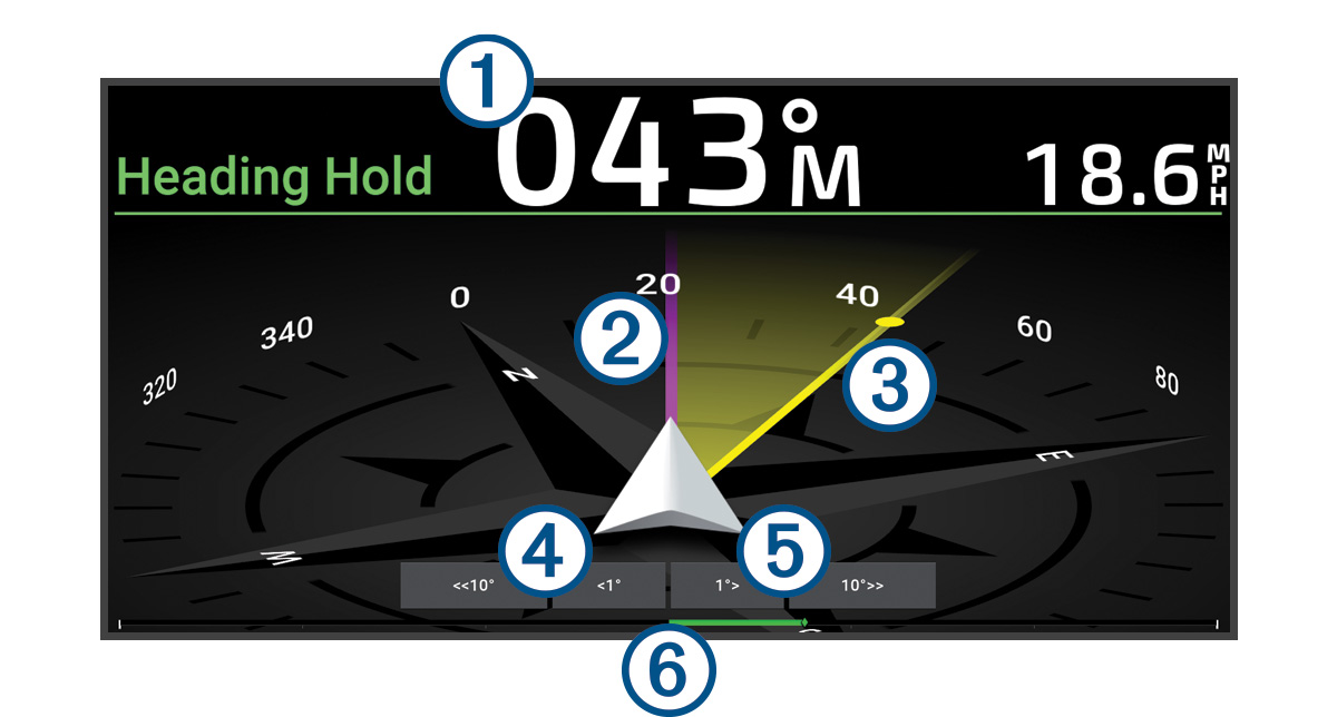

Autopilot Screen
Autopilot screen with callouts
1
Actual heading (when in standby mode)
Intended heading (when engaged)
2
Actual heading
3
Intended heading (heading the autopilot is steering toward)
4
Step turn to port (to adjust the intended heading by amount shown)
5
Step turn to starboard (to adjust the intended heading by amount shown)
6
Rudder position indicator (available when a rudder sensor is connected)
