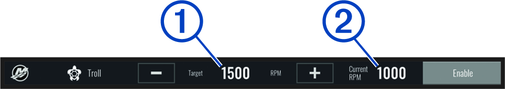

Mercury Troll Overlay
When connected to a compatible Mercury engine, you can use the Mercury Troll overlay on the chartplotter to set a target speed.
Mercury troll control bar with callouts
Minus symbol
Select to decrease the target speed
1
Target speed
Plus symbol
Select to increase the target speed
2
Actual speed
Enable
Select to engage the Mercury Troll feature
Disable
Select to disengage the Mercury Troll feature
