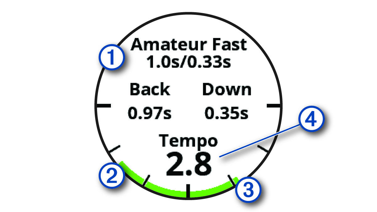

You can achieve the ideal 3.0 tempo using different swing timings, for example, 0.7 sec./0.23 sec. or 1.2 sec./0.4 sec. Each golfer may have a unique swing tempo based on their ability and experience. Garmin® provides six different timings.
The device displays a graph that indicates if your backswing or downswing times are too fast, too slow, or just right for the selected timing.
Swing tempo information with callouts
Callout number one
Timing choices (backswing to downswing time ratio)
Callout number two
Backswing time
Callout number three
Downswing time
Callout number four
Your tempo
Green
Good timing
Blue
Too slow
Red
Too fast
To find your ideal swing timing, you should start with the slowest timing and try it for a few swings. When the tempo graph is consistently green for both your backswing and downswing times, you can move up to the next timing. When you find a timing that is comfortable, you can use it to achieve more consistent swings and performance.
