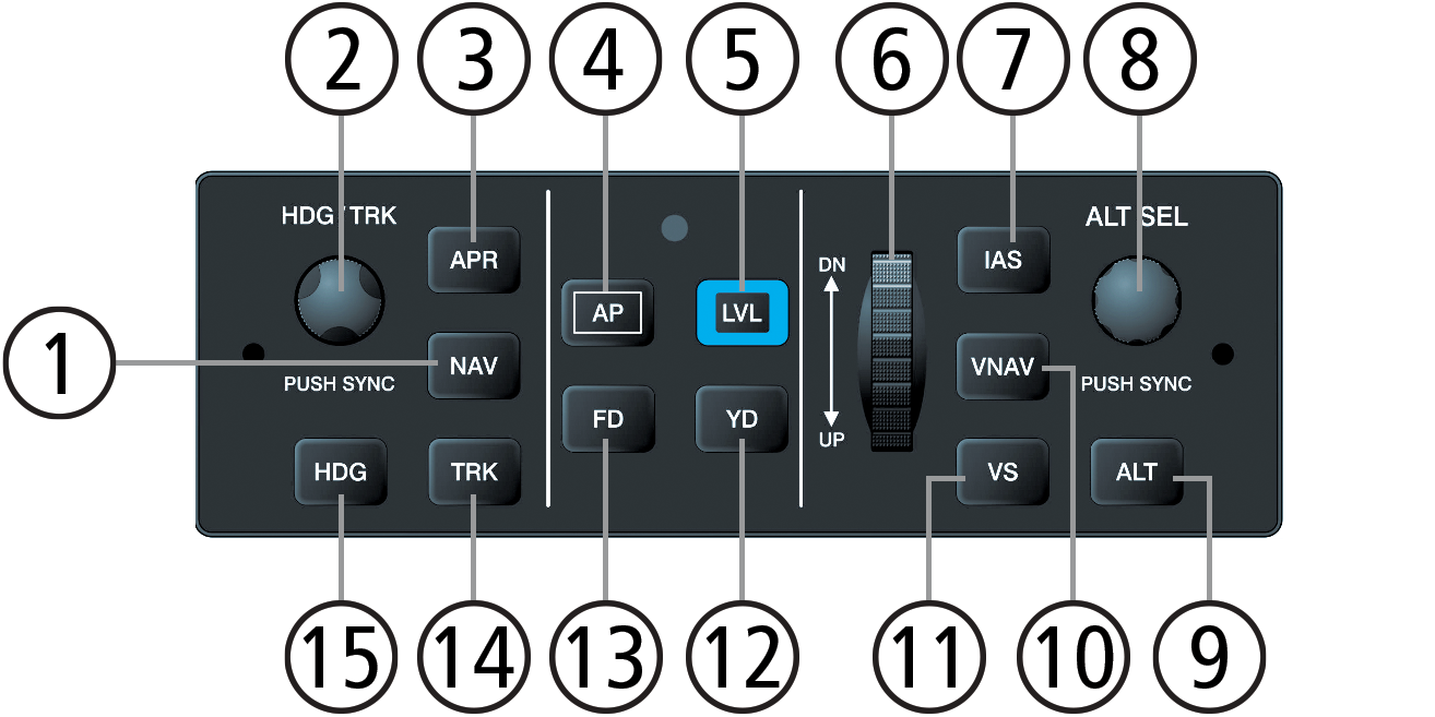

The AFCS Controller has the following dedicated AFCS controls:
1
NAV Key
Selects/deselects Navigation Mode. Cancels GS Mode if LOC Mode is either active or armed. Cancels GP Mode if GPS Mode is either active or armed. Cancels LOC Mode if GPS Mode is active and LOC Mode is armed.
2
HDG/TRK Knob
Selects the desired Heading/Track
3
APR Key
Selects/deselects Approach Mode
4
AP Key
Engages/disengages the autopilot
5
LVL Key
Engages the autopilot (if the autopilot is disengaged) in level vertical and lateral modes
6
Nose UP/DN Wheel
Adjusts the vertical mode reference in Pitch Hold, Vertical Speed, Indicated Airspeed, and Altitude Hold modes
7
IAS Key
Selects/deselects Indicated Airspeed Mode
8
ALT SEL Knob
Selects the desired Altitude setting
9
ALT Key
Selects/deselects Altitude Hold Mode
10
VNAV Key
Selects/deselects Vertical Path Tracking Mode for Vertical Navigation flight control
11
VS Key
Selects/deselects Vertical Speed Mode
12
YD Key
Engages/disengages the yaw damper
13
FD Key
Activates/deactivates the flight director only Pressing once turns on the director in the default vertical and lateral modes. Pressing again deactivates the flight director and removes the Command Bars. If the autopilot is engaged, the key is disabled.
14
TRK Key
Selects/deselects Track (TRK) Mode
15
HDG Key
Selects/deselects Heading Select Mode
