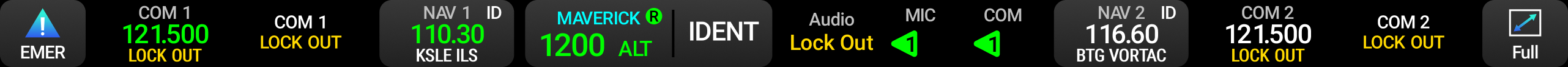

Lockout Mode can manually be activated by holding the transfer key for approximately two seconds. After Lockout Mode has been activated (for longer than two seconds), it can be exited by holding the transfer key for two seconds again. Once Lockout Mode is exited, most controls are restored to their initial values. The banner message below the HSI will read, "Audio Controls Locked: Hold Freq Swap to Unlock" while Lockout Mode is active. Indications on the COM radio buttons while in Lockout Mode can be reviewed in the figure below.
