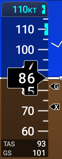

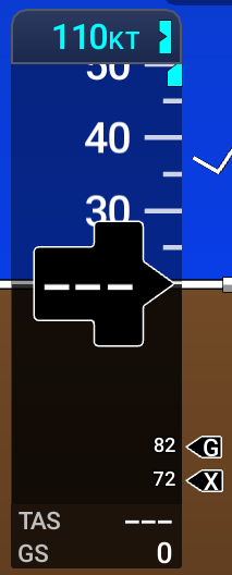

When an airspeed is actively displayed, the Vspeeds configured are also displayed at their respective locations to the right of the airspeed scale. While below the active airspeed range the Vspeeds are displayed in a list at the bottom of the airspeed indicator.
48: Vspeed References (with airspeed)
49: Vspeed References (without airspeed)
