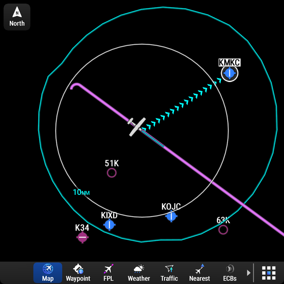

Bearing information will be provided on the map display toward a suitable, system-selected airport when Glide Range is enabled and ‘Ring & Glide’ is selected in the map settings. Bearing information will appear as a cyan dashed line of chevrons from the aircraft ownship icon to the system-selected glide range airport. For discussion on nearest glide range airports, refer to the Airports discussion later in this section.
149: Range Ring and Bearing to a Sytem-selected Glide Range Airport
