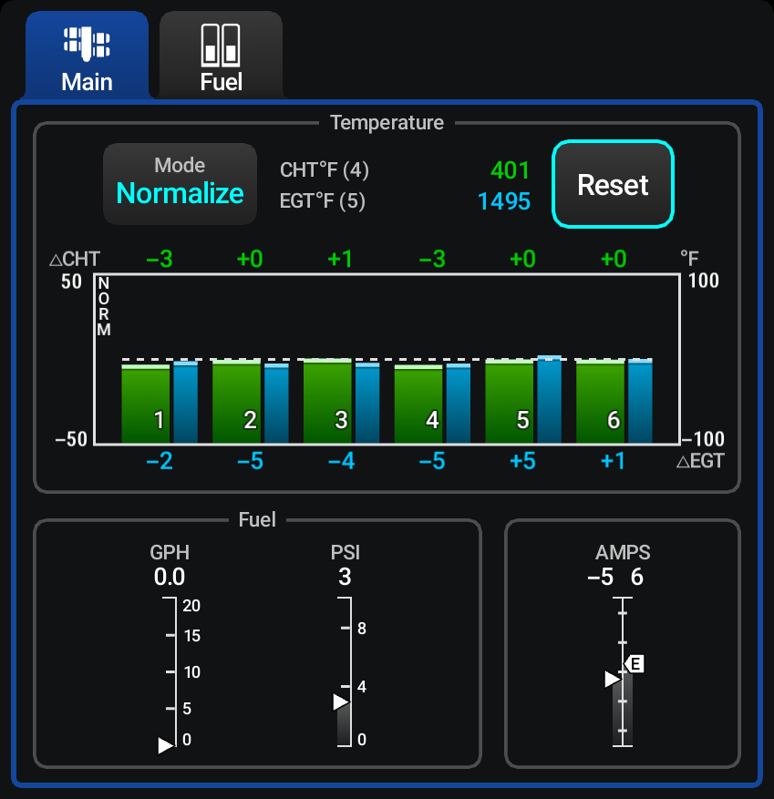

Normalization Mode
In Normalize Mode, the CHT/EGT Page displays the Cylinder Head Temperatures, Exhaust Gas Temperatures, and any TIT or Primary EGT temperatures relative to a normalized value. The bars of the graph and the digital values display the temperature difference from the normalized value.
Normalized values can be activated by selecting the Normalize Mode page. To reset the normalization touch the Reset Button.
In Normalization Mode, yellow and red line markings are not shown but the gauge will change color to alert the user if the threshold is exceeded.
99: Normalization Mode on the Engine Application Page
