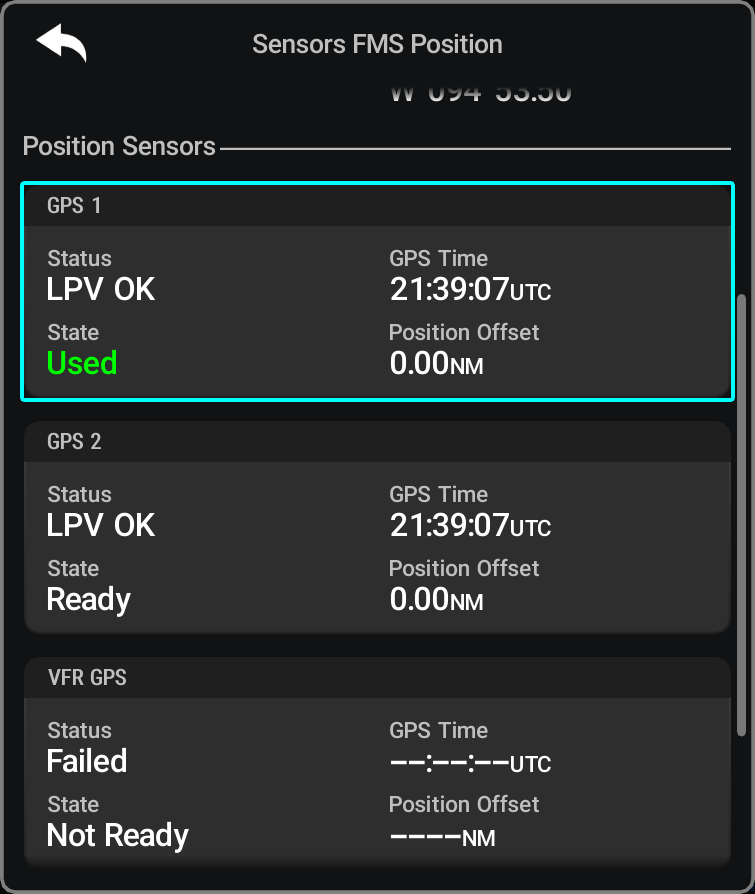

221: Position Fixing Sensors on the 'Position Sensors' Screen

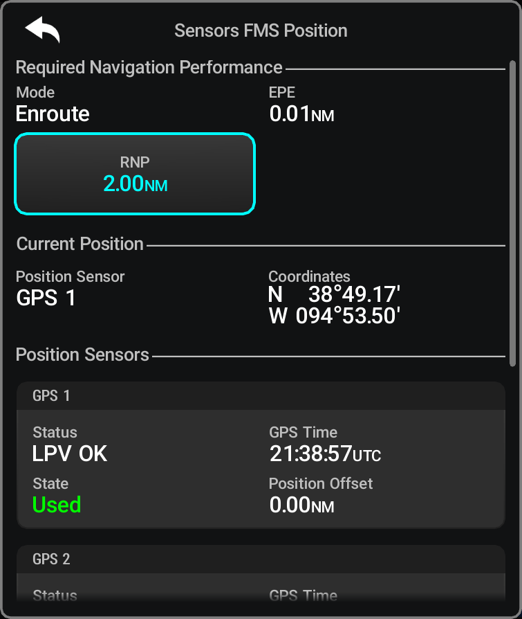

222: Current Position and Sensor in Use
