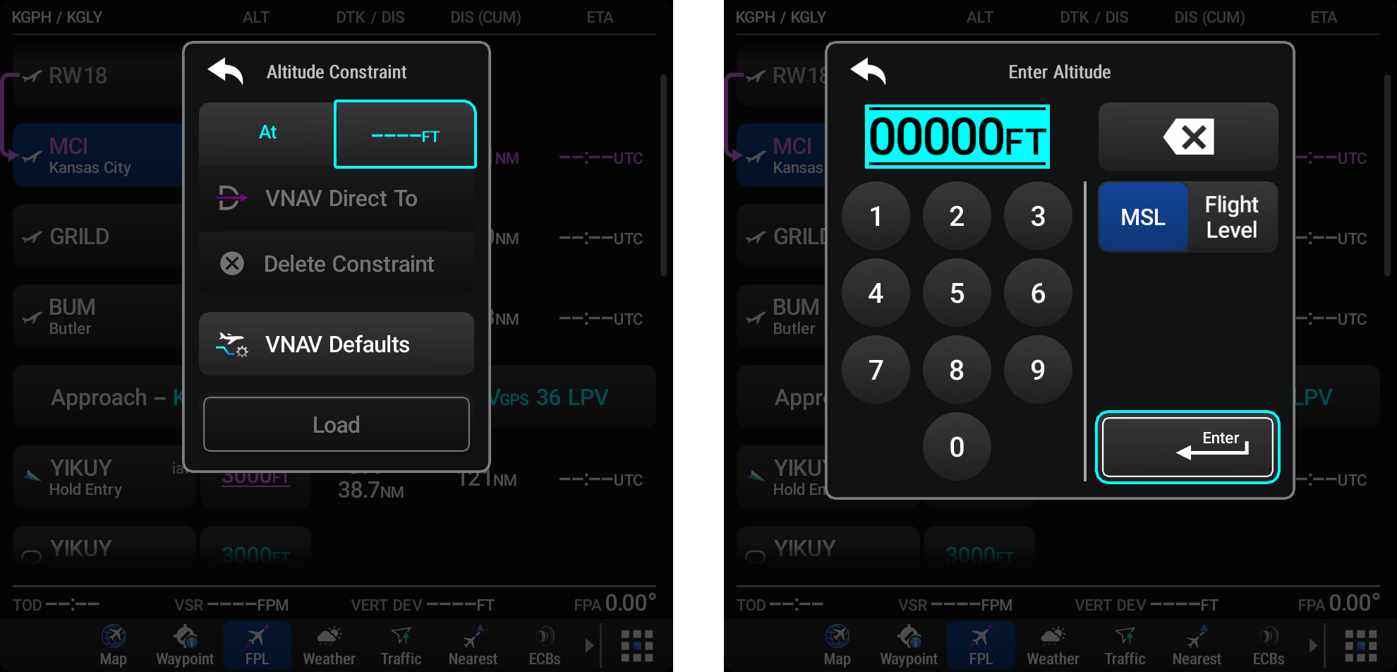

An altitude constraint may be displayed as a flight level (FL), height above mean sea level (MSL), or height above ground level (AGL). AGL format is only available for airport and runway waypoints when the radio altimeter is installed.
The type of altitude constraint shall be identified by the presence of constraint bars above and/or below the altitude. The vertical profile shall consider altitude constraints which must be crossed at the specified altitude, as well as complex altitude constraints (At or Above / Between / At or Below). Except during VNAV direct-to operations, the vertical profile considers all altitude constraints and creates an optimized profile descent from the TOD at the cruise altitude to the last descent constraint in the flight plan.
179: Altitude Constraint, Selecting the Constraint Type
180: Altitude Constraint, Modifying the Altitude and Loading into Flight Plan
