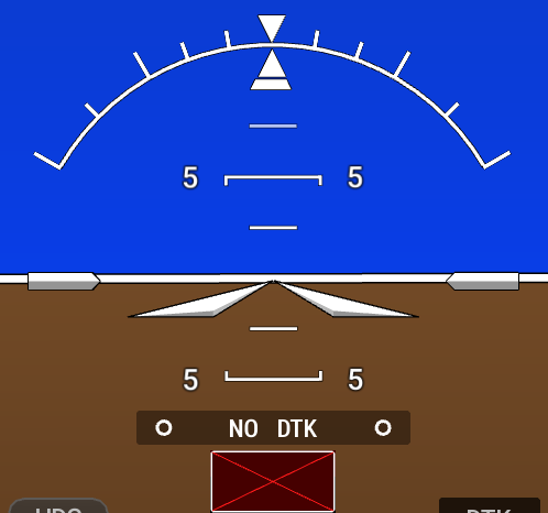

Attitude Indicator
ADAHRS Normal
Yes
Yes
Yes
Valid Pitch/Roll/Heading.

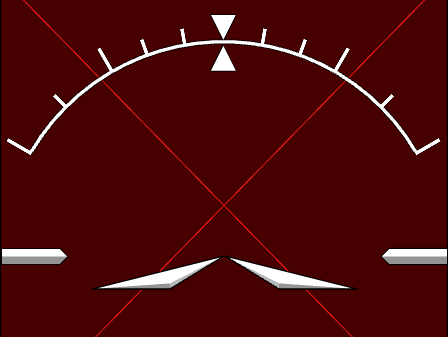

Invalid Pitch/Roll/Heading.

Loss of GPS, magnetometer, or air data inputs is communicated to the pilot by message advisory alerts. Any failure of the internal ADAHRS inertial sensors results in loss of attitude and heading information (indicated by red ‘X’ flags over the corresponding flight instruments). If the AXIS flight display senses that the magnetic heading measurement is valid, but possibly outside of the internal accuracy limits, the numeric heading value on the PFD is displayed in yellow.
If GPS input fails, the ADAHRS can continue to provide attitude and heading information to the PFD as long as magnetometer and airspeed data are available and valid.
If the magnetometer input fails, the ADAHRS continues to output valid attitude information; however, the heading output on the PFD Page is flagged as invalid with a red ‘X’.
Failure of the air data input has no effect on the ADAHRS output while ADAHRS is receiving valid GPS information. Invalid/unavailable airspeed data in addition to GPS failure results in loss of all attitude and heading information. Likewise, loss of magnetometer (heading) data, in combination with loss of GPS data results in a loss of all attitude and heading information.
