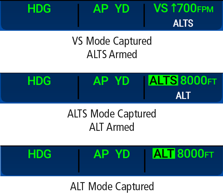

Armed modes are annunciated in white and active in green in the AFCS Status Box. Automatic mode transition from armed to active is indicated by the armed mode annunciation moving to the active mode field and displaying in inverse green and black for ten seconds (as demonstrated in the following figure).
271: Armed Modes and Active Modes in the AFCS Status Box
