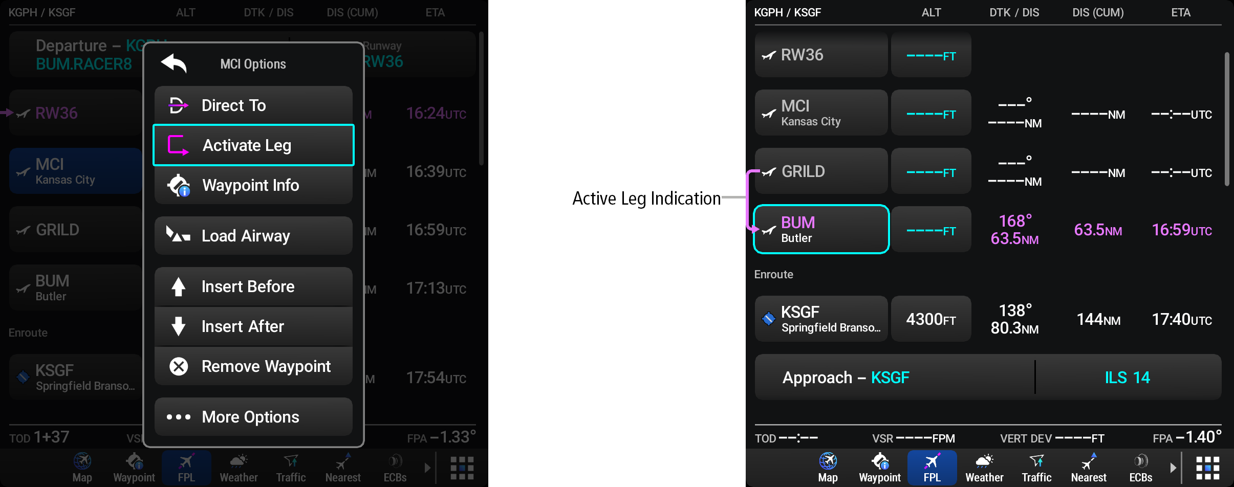

Activating A Flight Plan Leg
The system allows selection of a highlighted leg as the “active leg” (the flight plan leg which is currently used for navigation guidance). If necessary, the FMS will immediately provide a 45 degree intercept vector from the aircraft to the centerline.
183: Activating a Flight Plan Leg
